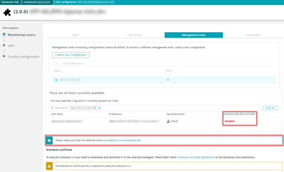

That's interesting because the monitoring config wizard is informing us to "make sure that the selected hosts are enabled to run extensions":
And the option to enable EEC is available even for PaaS hosts.
So, I assume enabling the EEC option on PaaS hosts is completely pointless as it will have no effect whatsoever, would you agree?

Agreed.I never tried, but I don't think it necessary enabling it in your situation. I should not have any effect on paas oneagents as they do not even include the EEC binaries and cannot run extensions. Except the ones running directly in instrumented applications. EEC as it says, executes the extensions, validates certificates and sends and enriches data.
