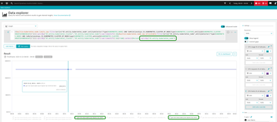

2. Monitoring gap
Changing the node id calculation method requires a renegotiation of which ActiveGate will be responsible for monitoring the Kubernetes cluster. This gap could last for 1 to 3 minutes and is expected behavior.
In the following example you see the gap and will recognize that there are two names with the same node name. The slightly different color in the chart indicates that two different Kubernetes node entities (with the same name) are stored to the metric.
