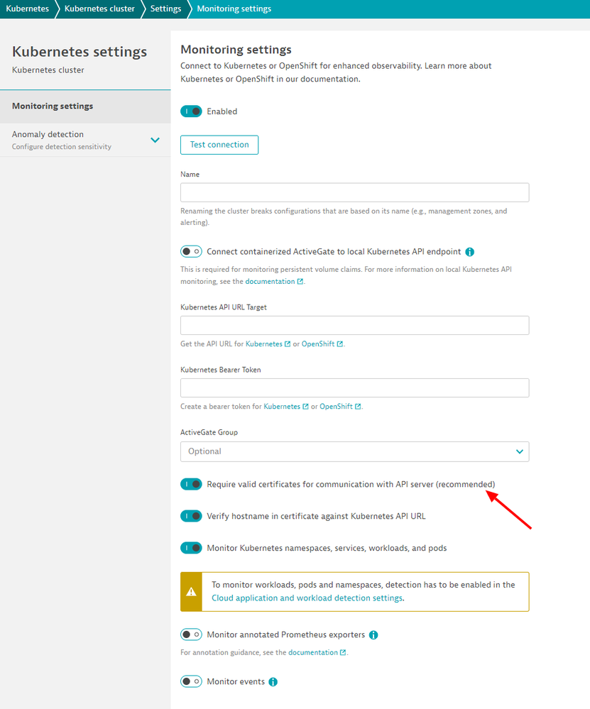

We're getting a TLS handshake error on our Cloud Foundry.
In the documentation I see that there's this option:
"If you haven't installed a trusted certificate to your ActiveGate, make sure to clear the Require valid certificates for communication with the API server (recommended) checkbox."
However, it is unclear where I can find this checkbox. I was not able to locate it.
12 Dec 2022 09:18 AM
Hello @KVZ ,
You can find this checkbox when you select "Connect manually" in the Kubernetes section of the menu. Then, you'll see the "Require valid certificates for communication with the API server (recommended)" checkbox right under the "ActiveGate Group" dropdown menu.
