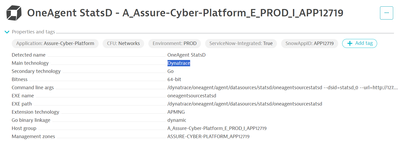

Within a DQL query, I am trying to filter processes based on the "Main Technology" of each process group, e.g. "Dynatrace" and "Elasticsearch". However, I can't seem to find the variable containing the "Main Technology" of each process.
I have tried looking for it in the following with no luck:
dt.entity
dt.entity.process
dt.entity.process_group
dt.entity.process_group_instance
But when viewing the process itself in the Dynatrace GUI, the "Main Technology" is stated plainly:
Could any one tell me what variable I should call in DQL to access the "Main Technology" information please?

Hi, this is ok when you want to find if a process/process group has or not a specific technology, but how to extract the Main technology like it's shown in process/process group page?
This is also my question.
How do I extract this property?
Whether from a process, a group of processes, or even services?
