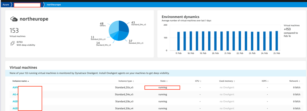

Is it possible to access the cloud VM running status from DQL?
In the integration there is a staus field. This seems to be correct even if for some reason the platform-level metrics are not showing correctly. I would like to access this status with DQL to use in a dashboard that I'm building.
The dt.entity.azure_vm does not have such dimension, it is also not a metric. What is it?
 I would appreciate any help.

I tried this approach, but if applied with long enough time window it will mix stopped VMs with the ones that no longer exist. It seems that it's based exclusively on the last metric datapoint available to dynatrace for the given entity.  I mentioned in my question that I observed a correct status (running)  in Dynatrace even if the VM metrics were not available.
At the same time I observed a message like this in the activeGate log
<vtopology.provider>, VirtualMachineEntity] Received null or empty PowerState for VirtualMachine: VirtualMachineEntity{type=AZURE_VM, entityId=-524919XXXXXX, name=XXXX-XX-XX-01, resourceId=....
It suggests that Dynatrace makes API calls to get power status of the VMs
What I'm interested in is the power status. So as long as the VM exists it should be either running or stopped.
