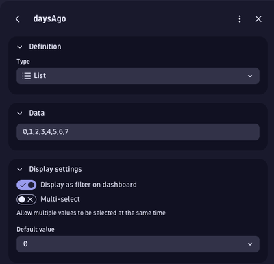

@cwinkler109 you can accomplish this using a list variable, for example:
Along with the following query:

As a side note, just so I understand it, are you looking to create a dashboard that shows logs for a given day between 5:50am and 6:30am local time? If so, you may get some inconsistent responses using bin() format based on the timezone.
I've attached a copy of an example dashboard using this functionality and showing some differences between bin() and @d.
