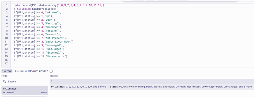

PR1_status is an array so it cannot be used in join condition directly.
I see that you are trying to translate numeric statues into text and the list of possibilities is rather short and static. This could be a query solving it:
timeseries PR1_status = avg(PR1_status), by: { device }
| fieldsAdd Status=coalesce(
if(PR1_status[]== 0,"Unknown"),
if(PR1_status[]== 1,"Up"),
if(PR1_status[]== 2,"Down"),
if(PR1_status[]== 3,"Warning"),
if(PR1_status[]== 4,"Shutdown"),
if(PR1_status[]== 5,"Testins"),
if(PR1_status[]== 6,"Dormant"),
if(PR1_status[]== 7,"Not Present"),
if(PR1_status[]== 8,"Lower Layer Down"),
if(PR1_status[]== 9,"Unmanaged"),
if(PR1_status[]== 10,"Unplugged"),
if(PR1_status[]== 11,"External"),
if(PR1_status[]== 12,"Unreachable")
)on simulated data it looks like this:
