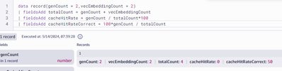

Order of operations matters here, especially these are integer operations:
2/4*100 = 0*100 = 0
but
100*2/4 = 200/4 = 50.
Here is DQL example:
data record(genCount = 2,vecEmbeddingCount = 2)
| fieldsAdd totalCount = genCount + vecEmbeddingCount
| fieldsAdd cacheHitRate = genCount / totalCount*100
| fieldsAdd cacheHitRateCorrect = 100*genCount / totalCount
