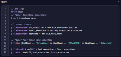

Hi @gbaudart, thanks for your reply.
I tried this DQL command :
I just changed the name of the column in english (and not in french).
But "timeDiff" is still on "null", does that means that timeDiff is not able to calculate time interval with 2 iso formats ?

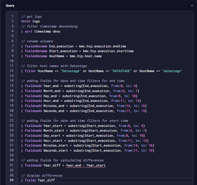

If it's not possible to calculate the time interval, i tried an alternative way (only if the DQL above is not the solution) :
(i tried an alernative way to do substings with the timestamp in order to get and associates numbers with Year, month etc)
It's done like this :
But i get an error that shows it's not possible to calculate between numbers (or i don't understand the error message).

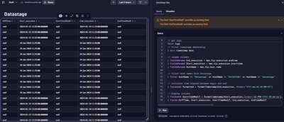

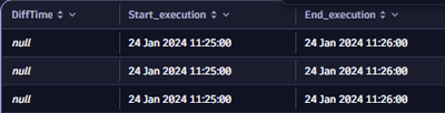

25 Jan 2024 12:51 PM
DiffTime is still on "null"
Even if i change to End_execution and Start_execution
Even when i display everything, I have null on StartTime and EndTime :

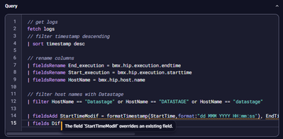

25 Jan 2024 02:17 PM - edited 25 Jan 2024 02:20 PM
// get logs
fetch logs
// filter timestamp descending
| sort timestamp desc
// rename columns
| fieldsRename End_execution = bmx.hip.execution.endtime
| fieldsRename Start_execution = bmx.hip.execution.starttime
| fieldsRename HostName = bmx.hip.host.name
// filter host names with Datastage
| filter HostName == "Datastage" or HostName == "DATASTAGE" or HostName == "datastage"
// display columns
| fieldsAdd StartTimeModif = formatTimestamp(Start_execution,format:"dd MMM YYYY HH:mm:ss"), EndTimeModif = formatTimestamp(End_execution,format:"dd MMM YYYY HH:mm:ss"), DiffTime = EndTimeModif - StartTimeModif
| fields DiffTime, Start_execution, StartTimeModif, End_execution, EndTimeModif

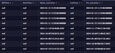

25 Jan 2024 02:48 PM
By doing a test, when I do "formatTimestamp", the default timestamp is correct but even when the Endtime is with the same format as the timestamp, still got a null.
I really don't get it... 😞
fetch logs
| sort timestamp desc
| filter bmx.hip.host.name == "Datastage"
| fieldsAdd formatted = formatTimestamp(timestamp, format:"MM-dd-YYYY")
| fieldsAdd formatted2 = formatTimestamp(bmx.hip.execution.endtime, format:"MM-dd-YYYY")
| fields timestamp, formatted, bmx.hip.execution.endtime, formatted2

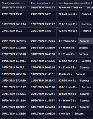

25 Jan 2024 03:37 PM - edited 25 Jan 2024 03:51 PM
So I finally arrived at the end result 🙂
What I did ?
The start time (as bmx.hip.execution.starttime) and end time (as bmx.hip.execution.endtime) were converted to timestamp formats with this lines :
// convert start and end times to timestamp format
| fieldsAdd bmx.hip.execution.endtime = toTimestamp(bmx.hip.execution.endtime),
bmx.hip.execution.starttime = toTimestamp(bmx.hip.execution.starttime)
And then I added a new field to substract the endtime with the starttime.
| fieldsAdd bmx.hip.execution.duration = bmx.hip.execution.endtime - bmx.hip.execution.starttime
Final dql :
// get logs
fetch logs
| sort timestamp desc
| filter bmx.hip.host.name == "Datastage" or bmx.hip.host.name == "DATASTAGE" or bmx.hip.host.name == "datastage"
| filter loglevel == "NOTICE" or loglevel == "NONE" or loglevel == "DEBUG"
// display columns
| fields content, bmx.hip.execution.starttime, bmx.hip.execution.endtime, bmx.hip.execution.duration, bmx.hip.execution.status
// rename columns
Final visual result :
Thanks @gbaudart and @krzysztof_hoja for your help !
