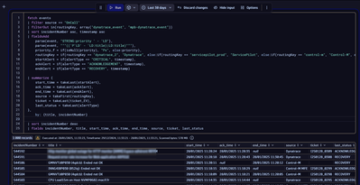

28 Jan 2025 10:41 AM
Hello @Tiit_Hallas,
Thanks for your help. I'm not yet comfortable with DQL, I'm still discovering some things (like the "summarize" command). I adapted it slightly to add some necessary fields to my dashboard, and I get everything back as it should:

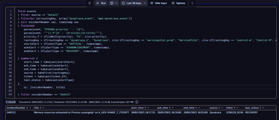

So, after having validated on a particular alert (this makes the verification more readable), I deactivated the filter so that it applies to all the fields but there, I no longer have the fields filled in:

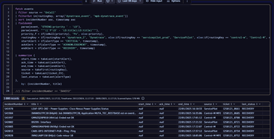

I have the impression that it only takes the last parameter (in our case, the end_time). I tinkered a little and I saw that by changing the order of the "by" parameter and specifying to sort by the incidentNumber, it worked as well for a targeted element as for the entire dashboard:
Thanks again for your help. Have a nice day,
