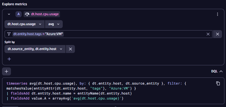

@Fast Please try similar to below
Phani Devulapalli

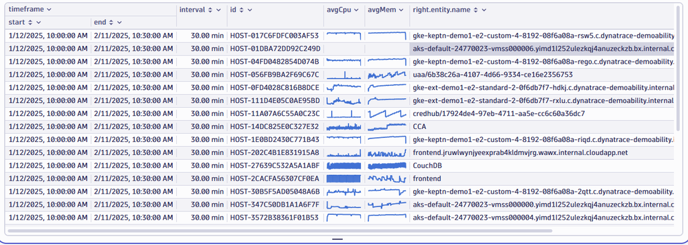

Hi @Fast
I am posting  here a similar solution but by searching hostname, you can find the query below.
timeseries {avgCpu = avg(dt.host.cpu.usage),avgMem = avg(dt.host.memory.usage)}, by:{dt.entity.host}, interval:30m
| fieldsRename id = dt.entity.host
| join [fetch dt.entity.host | fieldsAdd entity.name],on: {id}
| filter right.entity.name == $Search_Host
But You have to first create a variable for Search_Host which will take your hostname and checks the hostname that is equal to resulted hostname and filters the result. You can also use contains() here to get the results matching with Search_Host Variable.
You can modify the above query to get remaining metrics and add other variables to furthur extend the query.
If you need furthur help in this, reply.
