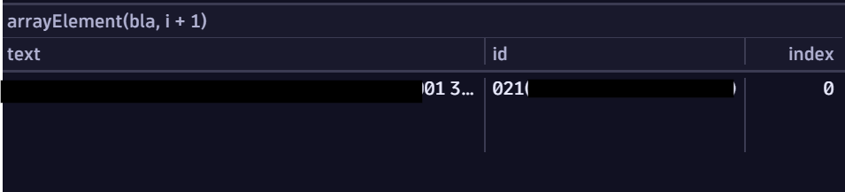

and my goal is to reiterate element extraction from the array to be displayed as columns.
For instance if I use DQL function arrayElement I can extract one single element and this will be displayed on a single row as follow:
What if I want multiple column per each element of the previous array?
Wish someone can help on this 🙂 @krzysztof_hoja

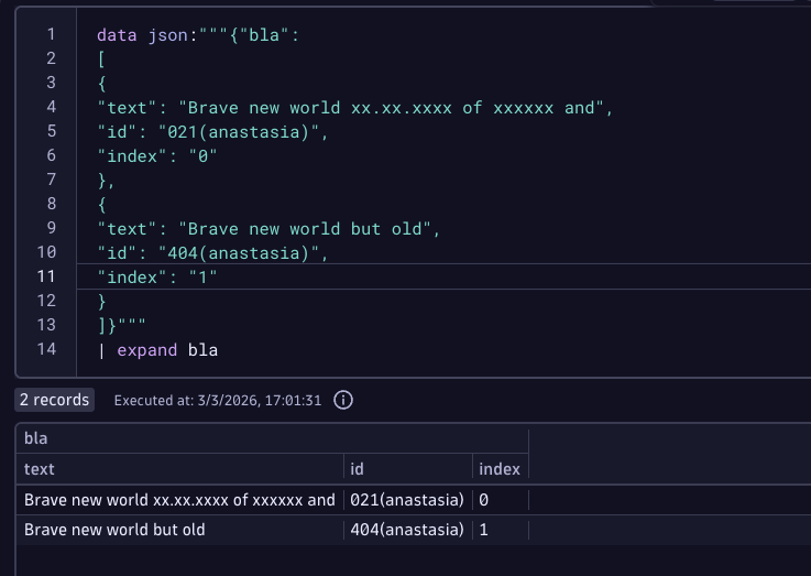

I am not sure if you need this:
data json:"""{"bla":
"text": "Brave new world xx.xx.xxxx of xxxxxx and",
"id": "021(anastasia)",
"index": "0"
"text": "Brave new world but old",
"id": "404(anastasia)",
"index": "1"
| expand bla

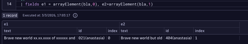

or this (when you know you have just 2 elements)
| fields e1 = arrayElement(bla,0), e2=arrayElement(bla,1)

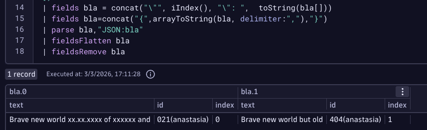

or this which works for any array:
| fields bla = concat("\"", iIndex(), "\": ",  toString(bla[]))
| fields bla=concat("{",arrayToString(bla, delimiter:","),"}")
| parse bla,"JSON:bla"
| fieldsFlatten bla
| fieldsRemove bla
Ei this is the solution: "works for any array" the one at the bottom that you provided.
| fieldsFlatten bla
| fieldsRemove bla
