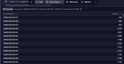

I get what I'm looking for for all the intervals where I have events. The problem is that the intervals where I don't have any data don't have the value "0". They're just not recorded...
But I need them, because then I'd like to average the number of events per minute. To do this, I need to count all the minutes, not just the ones with data.
Here's my current result, I'm missing all the data for the intervals between 5am and 5:36am:
