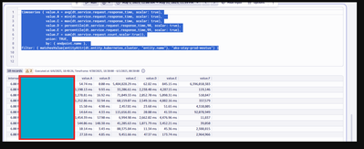

timeseries { value. A = avg(dt.service.request.response_time, scalar: true),
value. B = min(dt.service.request.response_time, scalar: true),
value. C = max(dt.service.request.response_time, scalar: true),
value. D = percentile(dt.service.request.response_time,90, scalar: true),
value. E = percentile(dt.service.request.response_time,99, scalar: true),
value. F = sum(dt.service.request.count,scalar:true)},
union: TRUE,
by: {endpoint.name},
filter: { matchesValue(entityAttr(dt.entity.kubernetes_cluster, "entity.name"), "xxx")}
can anyone help me with this query, as i need to another column where i need the number of request count that are greater than value D.
for eg. the first value for column D is 62.82ms so that i need the request count that are greater than 62.82ms, similarly for the other values in D columns

Thanks for the response, much appreciated, i too tried this but there is a huge difference that i can see in MDA.
Is there is any way we can filter out using response time greater than
The MDA will give different results because it is powered by trace data in the background. This means every time you view the data, Dynatrace is analyzing all the raw traces to count up how many took more than a certain amount of time.
The metrics for service response time are aggregated as timeseries data, which means that some of the detail available in the raw traces is lost. This is why percentile aggregations on metrics are technically always 'estimates' with a certain margin of error.
