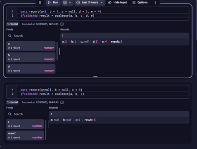

Would doing a coalesce() funtion work for you in this scenario? Here are a couple of simple examples:
Also here is the documentation on that function: here

thanks, asamay/marco. i actually gonna need it in time series as we will use davis ai/anomaly detector (which requires time series). i also tried coalesce() function but i can't get the desired result.
