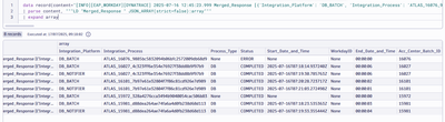

Hi @ramchandgadde
Your data sample made me think of a JSON Array, so I tried this :
| parse content, """LD "Merged_Response " JSON_ARRAY(strict=false):array"""
| expand arrayWith that I get a record for each array member, like this :
depending on your use case, that can be helpful
