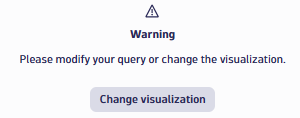

Please note even when commenting out the last line, I can't get error and total to be visualized:
