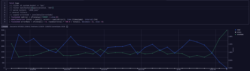

Last line should look like:
| fieldsAdd errorRate = if(total[] > 0, round(errors[] * 100.0 / total[], decimals: 2), else: 0)
you can find more information on iterative expressions here: https://docs.dynatrace.com/docs/discover-dynatrace/references/dynatrace-query-language/operators#ite...
My result on slightly different data, but with 2 last lines kept:
