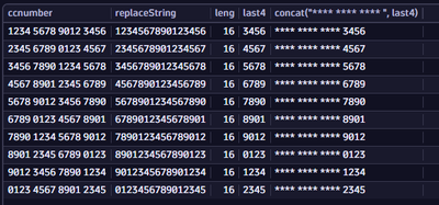

Anyway, my take on the "Scenario".
Probably don't need the replace string and can just use substring from whatever position you need.
These should really be filtered on ingestion an ideally not in logs at all. You do you...
data json:"""[
{ "ccnumber": "1234 5678 9012 3456" },
{ "ccnumber": "2345 6789 0123 4567" },
{ "ccnumber": "3456 7890 1234 5678" },
{ "ccnumber": "4567 8901 2345 6789" },
{ "ccnumber": "5678 9012 3456 7890" },
{ "ccnumber": "6789 0123 4567 8901" },
{ "ccnumber": "7890 1234 5678 9012" },
{ "ccnumber": "8901 2345 6789 0123" },
{ "ccnumber": "9012 3456 7890 1234" },
{ "ccnumber": "0123 4567 8901 2345" }
| fieldsAdd replaceString = replaceString(ccnumber," ","")
| fieldsadd leng = stringLength(trim(replaceString))
| fieldsAdd last4 = substring(replaceString, from: (leng -4 ))
| fieldsAdd concat("**** **** **** ",last4 )PS: I didn't realise you were in fact referencing https://docs.dynatrace.com/docs/shortlink/filter-and-search-commands#search . I'm not familiar with this feature at all so unsure if anything I said helps 😅

//| search "1234" // search all rows/columns
| fieldsAdd hidden = concat("**** **** **** ",last4 )
//| filter matchesValue(last4, "1234") // only search last four
| fields hidden
