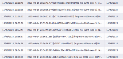

The problem seems to be that formatTimestamp(timestamp,format:"dd/MM/YYYY") seems to be working correctly in Notebook but not on a Dashboard. The issue seems to be with events with a timestamp up to 1hr after the midnight boundary getting allocated to the previous day.

This would seem to attribute to difference between 806 and 840
