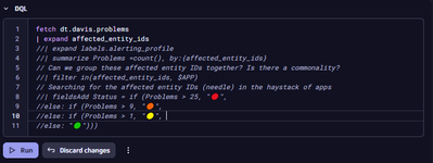

I have a dashboard where I want to fetch all the active problems and group the problems together by application. Then, using a variable that sorts through applications, I want to use that variable as a multi-select filter.
However, when I fetch active problems, I don't see any category that groups together problems by application. I see options to group by alerting_profile, display_id, affected_entity_id, etc..., but nothing to group by app.
 Is there any way to sort through the list of active problems and group them together by application?
