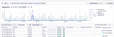

This is possible.  Set filter you want to use in Distributed Trace.  Click 3 dots on right and click on "Edit in Notebook" or "Pin to Dashboard"
Once there, click on Options then Line
Click Run

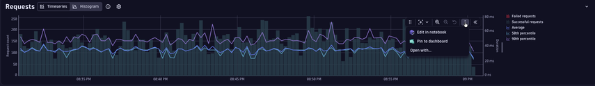

krzysztof_hoja
Dynatrace Champion
Dynatrace Champion
It is also possible to do the same for top chart. I was not able initially to find "three dots" for top chart. When you hover the chart menu open in upper right corner and you can get it directly as in app
