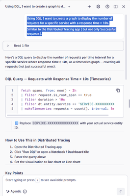

Dynatrace Assist:
Here's a DQL query to display the number of requests per time interval for a specific service where response time > 10s, as a timeseries graph — covering all requests (not just successful ones):
DQL Query — Requests with Response Time > 10s (Timeseries)
fetch spans, from: now() - 2h
| filter request.is_root_span == true
| filter duration > 10s
| filter dt.entity.service == "SERVICE-XXXXXXXXXXXXXXXX"
| makeTimeseries requests = count(), interval: 1m
🔁 Replace SERVICE-XXXXXXXXXXXXXXXX with your actual service entity ID.
How to Use This in Distributed Tracing
  1. Open the Distributed Tracing app
  2. Click "Run DQL" or open a Notebook / Dashboard tile
  3. Paste the query above
  4. Set the visualization to Bar chart or Line chart
Key Points
Element Explanation
request.is_root_span == trueCounts only entry-point requests (like the Distributed Tracing app does), not internal/child spans
duration > 10sFilters spans with response time exceeding 10 seconds (10s is a valid DQL duration literal)
No request.is_failed filterIncludes both successful and failed requests
makeTimeseries ... count()Produces a time-bucketed series suitable for a graph
interval: 1mAdjust granularity — use 5m, 10m, etc. for longer timeframes
Optional: Filter by Service Name Instead of ID
If you prefer to filter by name rather than entity ID:
| fieldsAdd service_name = entityName(dt.entity.service)
| filter service_name == "your-service-name"
Optional: Break Down by Service (All Services)
To see all services with slow requests in one graph:
| makeTimeseries requests = count(), interval: 1m, by: { service_name }

@Kenny_Gillette  : I see you're using Dynatrace Assist. I've tried it, but I've never managed to get a correct solution. What question did you ask the AI?
Glad we could help you.  I copied your question exactly and put in DT assist
