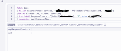

I am trying to write query to get “Response Time” Average. I am getting Null, when I ran the below query. Can someone please help me on how to calculate the Average of “Response Time”?

Hello,
For what you are sharing can be that Dynatrace is detecting the value as a String. To check the type use type(ResponseTime) and if it is a String then change it to Number using asNumber(ResponseTime).
Hope you a good monitoring!
