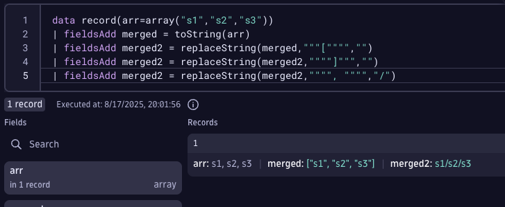

Unfortunately there is no function where you can specify new delimiter. There is however toString function. This example should explain how it works and how to achieve what you need:
data record(arr=array("s1","s2","s3"))
| fieldsAdd merged = toString(arr)
| fieldsAdd merged2 = replaceString(merged,"""["""","")
| fieldsAdd merged2 = replaceString(merged2,""""]""","")
| fieldsAdd merged2 = replaceString(merged2,"""", """","/")
Ahaaa, I tried asString, but now I see in the documentation that all as... functions just verify the type and return null otherwise. If I want to cast, I need to use the to... functions — in this case toString.
Thanks also for the extra tips on how to set a custom delimiter 🙂
