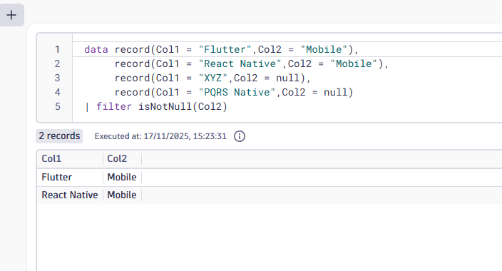

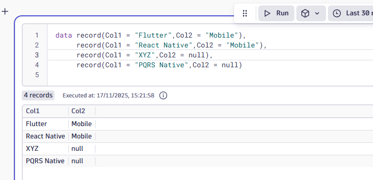

18 Nov 2025 05:21 AM - edited 18 Nov 2025 05:49 AM
Consider Having a column in dql records which contains null, we can remove null values by using built in function of DQL as shown below.
The Above Image Shows the column with null values. Now Use the below Query to remove null values.

| filter isNotNull(Col2)
Now the Result be as shown below.
Thanks
21 Nov 2025 09:43 PM
Sorry, that isn't what I'm looking for. In your example, you omitted two rows of data because, when you filter for isNotNull(Co2), it only returns rows where Col2 is not Null, meaning we didn't get the data in Col1 for those two rows shown.
