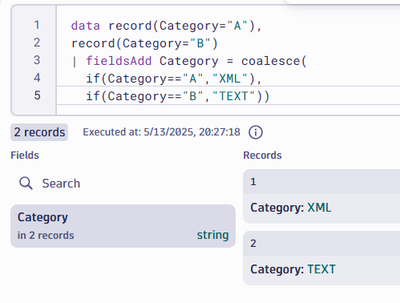

if "Category field has two results either A or B" why do you need replaceString, not just if?
If my understanding of assumption is correct, this could look like this:
data record(Category="A"),
record(Category="B")
| fieldsAdd Category = coalesce(
  if(Category=="A","XML"),
  if(Category=="B","TEXT"))
This works too. Thank you for the response.

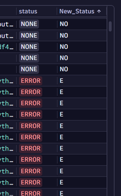

Can you try this :
| fieldsAdd CategoryReplaced = replaceString(replaceString(Category, "A", "XML"), "B", "TEXT")
please check the simple Example :
