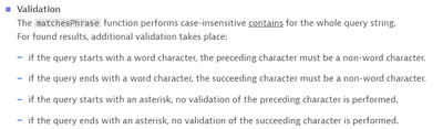

Maybe in the event.name field, there is a non-word character succeeding the word "restarting" (eg. a dot or a comma) so that the matchesPhrase is not validated without the wildcard.
Hope this helps
11 Oct 2023 04:11 PM
If there was a dot or a common I'd see it. Added a == to make the problem even more clear. Note that "restarting" obviously starts and ends with a word character, and before and after it are non-word characters, so it meets the criteria for matchesPhrase. I'll be doing training with some people at my company and at this point I will be recommending they use contains and not matchesPhrase.

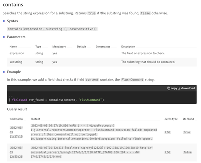

Unable to find documentation for "contains"...
