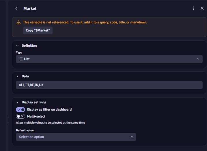

IMO you should set it like this:
Variable 1
  • Name: Market
  • Type: List
  • Values: ALL,PT,DE,IN,UK

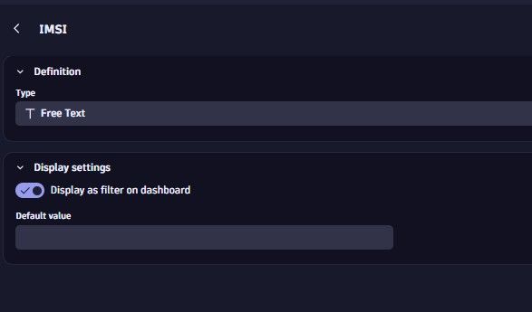

Variable 2
  • Name: IMSI
  • Type: Free Text
  • Default: empty
then you can use them in DQL, like this:
fetch logs, scanLimitGBytes:-1
| filter dt.system.bucket == "_engineering" and index == "serv_db"
| filter ($Market == "ALL" or Market == $Market)
| filter IMSI == $IMSI
| fields timestamp, AuditMessage, Market, IMSI
| sort timestamp desc
or you can also replace
to
| filter ($IMSI == "" or IMSI == $IMSI)
