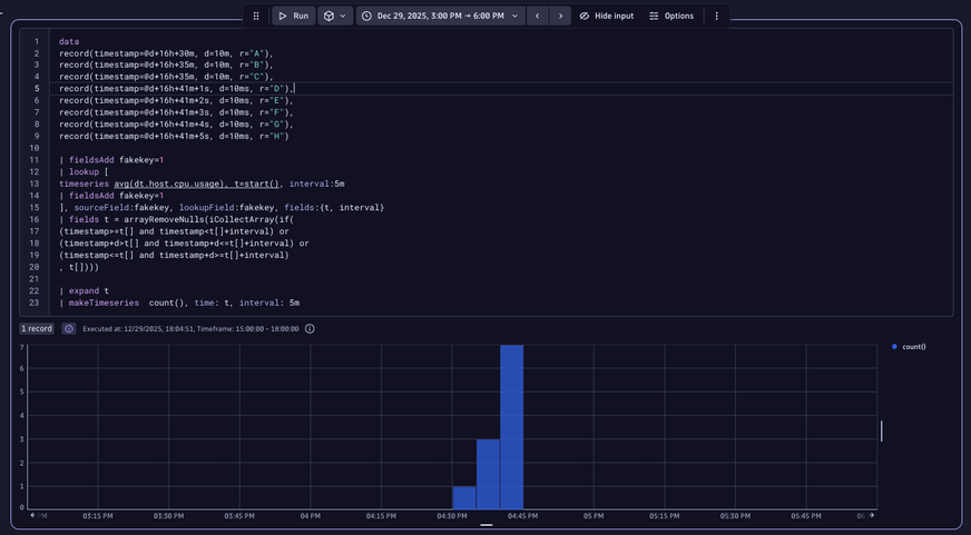

Second case is realatively easy. The challenge is to put each transaction against an array representing intervals of interesting period and cheching if each interval ovlaps with rach particula transation. Such array can be generated by using start() funtion in timeseries command with any present metric.
data
record(timestamp=@d+16h+30m, d=10m, r="A"),
record(timestamp=@d+16h+35m, d=10m, r="B"),
record(timestamp=@d+16h+35m, d=10m, r="C"),
record(timestamp=@d+16h+41m+1s, d=10ms, r="D"),
record(timestamp=@d+16h+41m+2s, d=10ms, r="E"),
record(timestamp=@d+16h+41m+3s, d=10ms, r="F"),
record(timestamp=@d+16h+41m+4s, d=10ms, r="G"),
record(timestamp=@d+16h+41m+5s, d=10ms, r="H")
| fieldsAdd fakekey=1
| lookup [
timeseries avg(dt.host.cpu.usage), t=start(), interval:5m
| fieldsAdd fakekey=1
], sourceField:fakekey, lookupField:fakekey, fields:{t, interval}
| fields t = arrayRemoveNulls(iCollectArray(if(
(timestamp>=t[] and timestamp<t[]+interval) or
(timestamp+d>t[] and timestamp+d<=t[]+interval) or
(timestamp<=t[] and timestamp+d>=t[]+interval)
, t[])))
| expand t
| makeTimeseries count(), time: t, interval: 5m
result looks like this:
