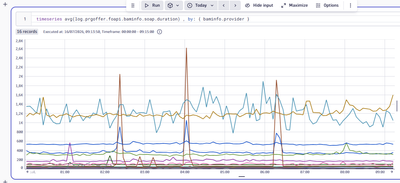

@enrico_afkl The data that you are querying , is that a timeseries data? What if you try to get a average , do you see data?
timeseries avg(log.prgoffer.foapi.baminfo.soap.duration) , by: { baminfo.provider }
25 Jun 2026 08:35 AM - edited 25 Jun 2026 08:36 AM
I did this for the first query, but now i would like to have the evolution in time with a line chart
16 Jul 2026 06:53 AM
@enrico_afkl Earlier DQL should work for line chart , you just need to change the visualization . Could you please elaborate the issue you are facing for better understanding ?
16 Jul 2026 08:16 AM
hello @p_devulapalli ,
I vcan see data but I'd like to have percentile and not just the average
thanks a lot for your help
