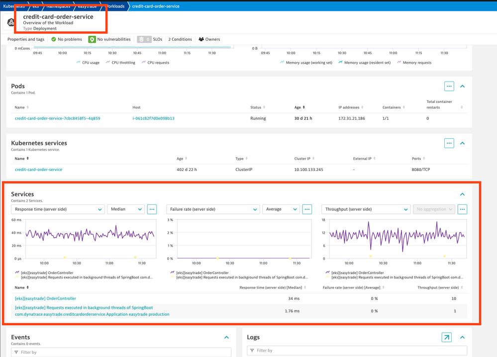

This returns all services related to a specific cloud application. In my case, it includes:
-Requests executed in background threads of SpringBoot for dine-in-api-*
-Web-server for dine-in-api-*
What I want to achieve is to get the Kubernetes workload names, which are visible in the “services” application (either in the filter bar or at the top of the service page). I plan to use these names as variables in a dashboard to display metrics like response time or failure rate, split by each service.

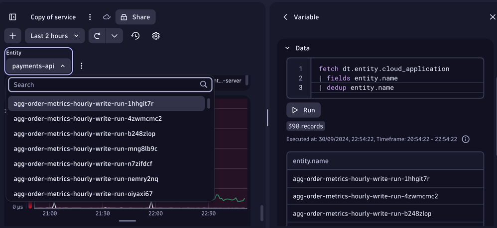

To get list of workload names to use in variable definition:
fetch dt.entity.cloud_application
| fields entity.name
| dedup entity.name
 Of course you can control what fields are in final results using fields of fieldsRemove commands.

@krzysztof_hoja thanks, second query indeed is solving the issue, thanks a lot.
is there an other option to list workloads?
If you want data related variable, one fed by DQL results is the easiest one to use.

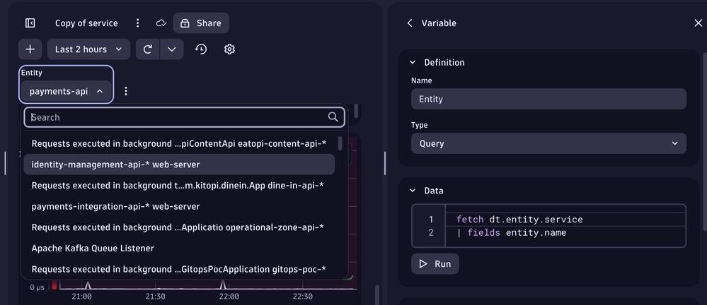

Hmm… the workload name (without a lot of trash) should be usable as a variable to create a tile that queries all related services
I am not sure what is your question here....
Query retrieving e.g. response time takes workload name ($Entity matching name of CLOUD_APPLICATION).
@krzysztof_hoja I would like a query that returns only the Kubernetes workloads and another one that returns all entities belonging to a specific workload. So the question is - how to achieve that?
