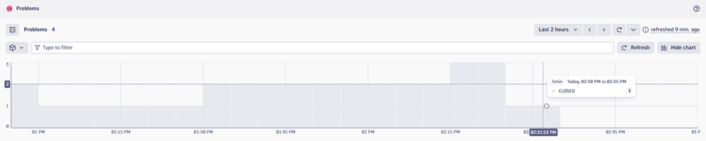

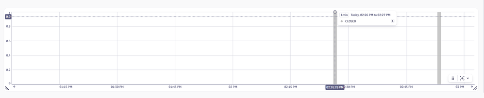

I’m trying to recreate the problem chart from the Problems menu using DQL, but I’m struggling to match the behavior of the native visualization.
Current approach:
fetch dt.davis.problems
| makeTimeseries count(), by: {event.status}Current result:
The problem only appears as a single bar at the timestamp field.
Expectation:
I want the problem to behave like the native Problems chart:
So essentially I’m trying to calculate “active/open problems over time”, not just “problem creation count”.

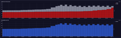

Hello @zaidanrizq!
I'm not sure if got right, but I think you want something like this:
If it's, you can use this Json below and then use as a dashboard, I made comments on the dashboard so you can understand better:

"query": "fetch dt.davis.problems, from: toTimestamp($dt_timeframe_from) - 2h, to: toTimestamp($dt_timeframe_to)\n| filter event.start <= toTimestamp($dt_timeframe_to)\n| filter coalesce(event.end, now()) >= toTimestamp($dt_timeframe_from)\n| makeTimeseries problems = countDistinct(display_id),\n by: { event.status },\n interval: 5m,\n spread: timeframe(from: event.start, to: coalesce(event.end, now()))",

"query": "fetch dt.davis.problems, from: toTimestamp($dt_timeframe_from) - 2h, to: toTimestamp($dt_timeframe_to)\n| filter event.start <= toTimestamp($dt_timeframe_to)\n| filter coalesce(event.end, now()) >= toTimestamp($dt_timeframe_from)\n| makeTimeseries problems = countDistinct(display_id),\n interval: 5m,\n spread: timeframe(from: event.start, to: coalesce(event.end, now()))",

29 May 2026 10:00 AM
It worked as expected, Thanks a lot!
