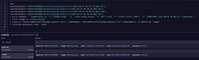

Here is an example calculating duration, hope it helps:
data
record(content="79895474545006\tPreProcessing\tstart\t1\t\t2023-04-27 04:23:12.000.153"),
record(content="79895474545006\tPreProcessing\tend\t1\t\t2023-04-27 04:30:38.000.153"),
record(content="79895474545005\tPreProcessing\tstart\t1\t\t2023-04-26 05:30:38.000.1538"),
record(content="79895474545005\tPreProcessing\tend\t1\t\t2023-04-27 04:30:38.000.153")
| parse content, """ALNUM:batch.id '\t' STRING:stage  '\t'  LDATA:stage_status '\t' INT?:valid '\t' FLOAT?:result PUNCT? '\t' TIMESTAMP('yyyy-MM-DD HH:mm:ss'):timestamp"""
| filter stage == "PreProcessing"
| summarize {start=takeFirst(if(stage_status=="start",timestamp)), end=takeFirst(if(stage_status=="end",timestamp))}, by:{batch.id, stage}
| fieldsAdd duration = end - start

Thanks Mark, tried including the 'By: Day' with a few modifications in the summarize. Works fine now.
