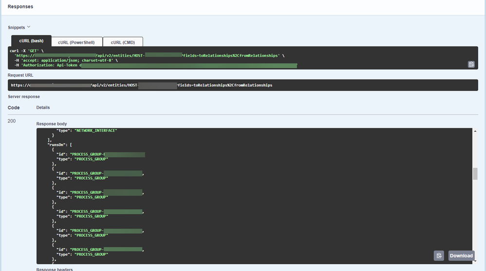

Is anyone aware of a DQL statement or notebook that can be formulated to dynamically give the friendly name of entities based off relationships?
For Example HostIDXXXXXX to/from relationships in the api we get the Dynatrace IDs. In the past we had to create an api that would take the result of the Host ID GET then submit multiple gets for the relationship items that were formulated from the first GET, just to get the friendly name.

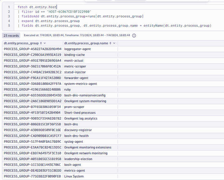

If I understand correctly, this could be a solution:
fetch dt.entity.host
| filter id == "HOST-6C867CD1BF3229B0"
| fieldsAdd dt.entity.process_group=runs[dt.entity.process_group]
| expand dt.entity.process_group
| fields dt.entity.process_group, dt.entity.process_group.name = entityName(dt.entity.process_group)
First get process groups entity IDs running on host and next lookup for their names. Result looks like this:

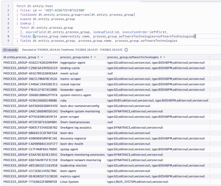

I used works "lookup" on purpose, because entityName (and similar entityAttr) function is easy to use wrapper of for lookup command where you can get many more entity properties in one step:
| lookup [
  fetch dt.entity.process_group
  ], sourceField:dt.entity.process_group, lookupField:id, executionOrder:leftFirst,
  fields:{process_group.name=entity.name, process_group.softwareTechnologies=softwareTechnologies}
| fields dt.entity.process_group, process_group.name, process_group.softwareTechnologies
