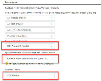

Thanks for your detailed answer.   I've not gotten to work yet, but still trying.
I setup a SOAPAction Request Attribute as follows.  What I'm finding though is it only shows up for the Server side and not any Client calls.
I'm working on setting up the Custom service also to see if maybe that will resolve the missing Requests, but need more time to find the right AXIS Library Java class to instrument since AXISClient.invoke isn't working.  I should be able to figure this out with some local debugging, but wanted thank you and let you know your post has been very helpful.  I'll mark it as accepted once I get things working.
