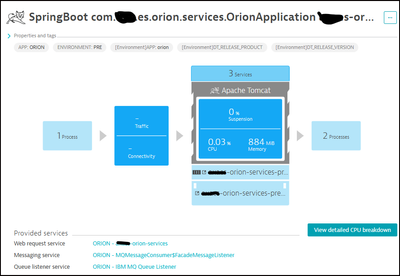

The DQL works correctly for some services, but for others it returns “no data”. However, by manually inspecting the service in question, I can see that it has ProcessGroups and instances that should be generating CPU data. There are even ProcessGroups identical to those of services that do work correctly with the script.

  • All the services in question belong to the same ProcessGroup, but their service types differ. Could this be contributing to the problem?

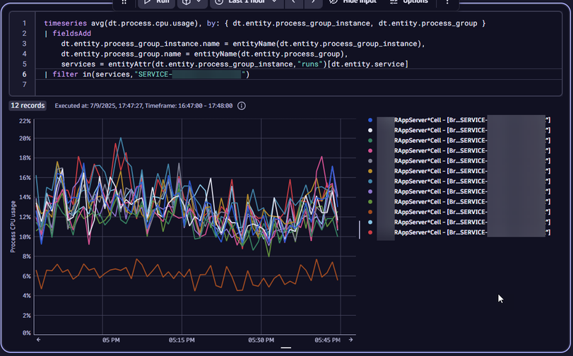

There's a simpler way to do this that I hope will work for you. The query happens in three steps:
  1. Grab the timeseries data for the process group instances. This is the first few lines of your existing query.
  2. Use the fieldsAdd command with the entityAttr() function to grab the entity relationship data as a new field. This replaces all the lookup stuff.
  3. Filter the list down to only show processes of interest and which host the service(s) in question, as you were pretty much doing already.
The DQL comes out like this:
timeseries avg(dt.process.cpu.usage), by: { dt.entity.process_group_instance, dt.entity.process_group }
| fieldsAdd
    dt.entity.process_group_instance.name = entityName(dt.entity.process_group_instance),
    dt.entity.process_group.name = entityName(dt.entity.process_group),
    value.CPU = arrayAvg(`avg(dt.process.cpu.usage)`),
    services = entityAttr(dt.entity.process_group_instance,"runs")[dt.entity.service]
| filter in(services,$Service)
Here's a snapshot of the output when filtered down to a single service ID:
