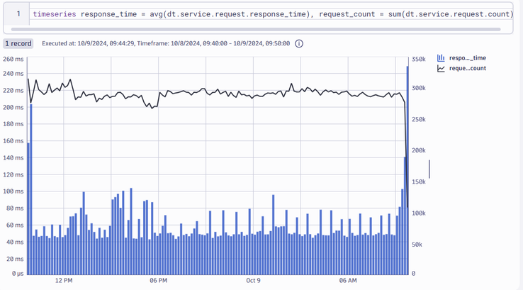

Hi @y_buccellato , you can try something similar to response time by request count? Use line chart for response time and bar for quantity in your case .Hope I understood your query correctly.
timeseries response_time = avg(dt.service.request.response_time), request_count = sum(dt.service.request.count)

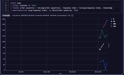

Hey @y_buccellato,
Based on what you're trying to find out you could try using the makeTimeseries command along with binning the order quantity to see if you can find trends that way.
In my example below each timeseries is grouped by the number of items in an order. For example the first group, the blue line, are orders with numbers of items between 0 and 49. The next group, white, is comprised of orders with items between 50 and 99. And so on. This can be modified to suite your needs, you could bin them into smaller groups if the maximum number of items is 50 or 100 or something like that you might bin by 5 or 10.

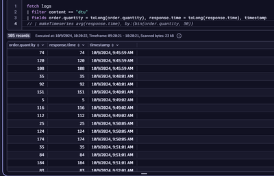

My example raw data looks like below.
Alternatively you could use makeTimeseries but just split by order quantity if the range of items in orders is fairly low and the number of total orders is high enough to create a nice timeseries.

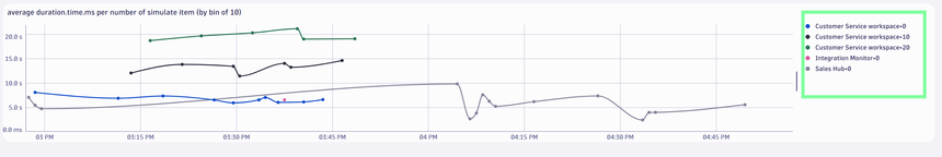

10 Oct 2024 04:02 PM
Just a small detail here - in the legend: is there any way to not show Bin 0 and then Bin 10; instead showing Bin from 0 to 9, bin from 10 to 19, etc.. ?

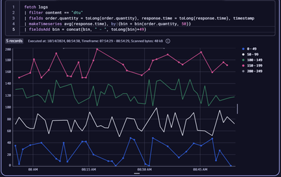

13 Oct 2024 11:00 PM
You would take the field you've put the bin amount into and use some string modifications to change it. As seen below I used concat to add " - #" to the end of each bin amount to show the range.
