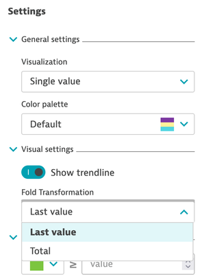

This is nowadays possible with the Data explorer. You can make use of the Last value fold transformation in the Build mode. You can also make use of the :last operator in the Code mode.
