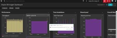

Hence, we would like to set some dashboards on a timeframe including today 09:00-18:00. This timeframe does not work, as part of the timeframe is still in the future every morning/afternoon. Yes, I could pick the today one, but that would be more zoomed out and also show non-office times which the customer does not care about. They also want to have the same constant x axis with the business hours. I know that there is no proper solution for this in the UI, but did someone maybe do some scripting to solve this? Otherwise I would put this in the idea box :).

Hello, actually you can customize your time frame with such method (today+9h to today+18h)
More about how you can customize timeframe you can find in Timeframe selector expressions
You can use this timeframe for all your dashboard set up or for induvidual tile.
