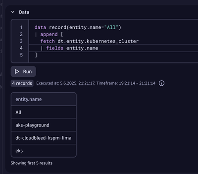

    1. Create an "Any" or "All" (naming is up to you) entry in your variable. For example by using data record()... and | append [...
    2. During referencing the variable value you deal with the all by dropping the filter
Workaround

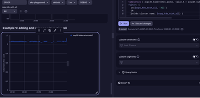

For example, to add an "All" to all kubernetes clusters you could do it like
And then during referencing you can simply do it like that, which if you select all "drops" the filter because its "true" and therefore doesn't actually filter.
Link to a working example on the playground https://playground.apps.dynatrace.com/ui/apps/dynatrace.dashboards/dashboard/30a2fd95-90e8-40d8-8387...
