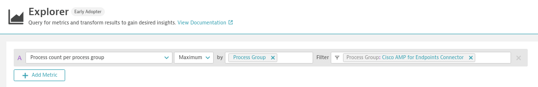

Well i don't recall this working this way actually. Im testing in 204 and 206 and both are the same, i was pretty sure that you could select an specific entity via dimension...
Any way, if you use the new Explorer to create the widget, you can select an specific process via filtering.
And then add it to the Dashboard.
