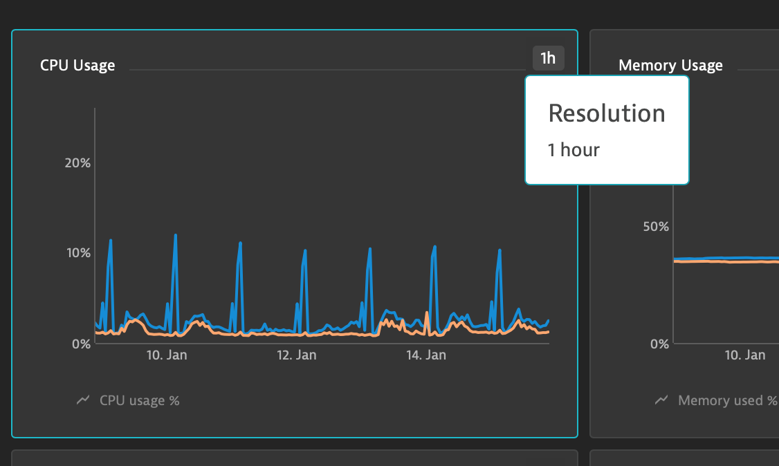

skrystosik
Now when you have custom chart on dashboard you can see it's resolution in right top corner. You can check timeframes that are interesting for you 🙂
Sebastian
Regards, Sebastian

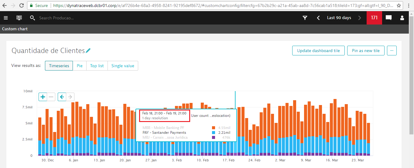

marco_yamana
Participant
In my case, when applying 90 days I have the resolution of 1 days as expected. But because I am 3 hours ahead of UTC, on my chart the days start at 9PM.
Is there a way around this?
One detail I am in a browser with the desktop with the same timezone as Cluster Management.
Marco
you could set a custom time frame and set it as desired
-Chad
