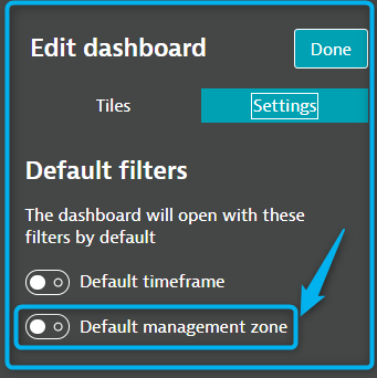

  • As per Dynatrace Management Zone definition, the monitored entities which are configured to be included in the intended management zone will be limited for the intended team as per the RBAC.
  • Having this option isn't available as of now, as the dashboard can be dedicated to only one management zone.
  • Meanwhile permitting access to dedicated users or user groups is an option also depending on the configured dashboard tiles that will present the monitoring insights.
  • You can consider the suggested solution by @Julius_Loman , it will work properly as long as the related entities are configured in both management if there is no need for entities segregation.
  • In case you need to segregate everything, configuring the observability tiles as per monitoring requirements and avoid limiting the dashboard to any management zones at all, so the access will be given to the intended users groups (App owners) without any issues and both teams will access the same dashboard with no doubt.
