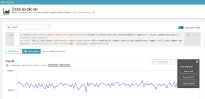

Hi @heramb_sawant , yes you can use it and the following is a sample to give you the availability percentage of a specific service, this sample you can use in the global demo environment
((100)*(builtin:service.errors.server.successCount:filter(and(in("dt.entity.service",entitySelector("type(SERVICE),entityName.equals(azure easytravelazure-weather-service)")))):splitBy())/(builtin:service.requestCount.server:filter(and(in("dt.entity.service",entitySelector("type(SERVICE),entityName.equals(azure easytravelazure-weather-service)")))):splitBy())):setUnit(Percent)

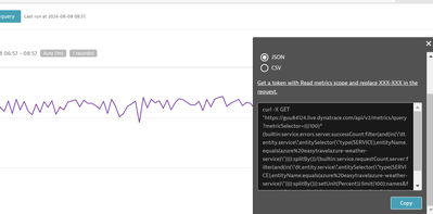

Can we get the same output( service availability % )  using dynatrace API??
Regards,
Heramb
Hi @heramb_sawant, yes, you can use metric API, using the above sample, you can copy the request as metric API directly same as the below screenshots
