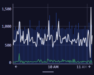

In the past, when we want to put different metrics data which come from the same application, we can define individual styles for different metrics, e.g. metrics A display in bar while metrics B and C display in lines.
However, in gen3 charts we can only define the general display style in the "Visual" tab.
Are there any ways we can display different styles within the same chart?

The only woraround that u can implement is split metrics into separate charts (one bar chart, one line chart) or overlay data conceptually by using multiple tiles aligned together
You can still achieve this but there will be nuances based on the dimension you use when you split the metric.
If you Have selected the bar chart you'll super impose bar to all.
Once you understand what is meaning full to have as line you can further click on "bars" and add (+) custom Geometry.
Please test it and see if it is fitting your use case 😀
Regards
I have tried with your suggestion and it works as expected.
Thank you for your help 😄
