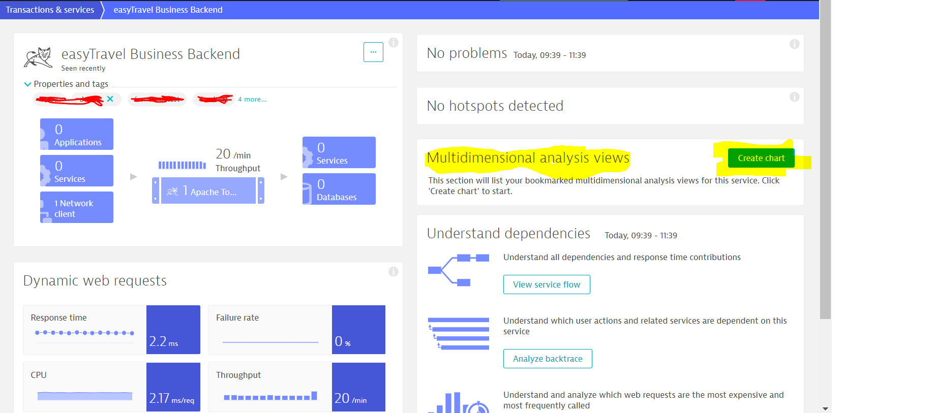

I would to create a chart with request from Nginx service splitted by HTTP return code but I'm not able to do this with Dyantrace OneAgent. Seems that only 4xx and 5xx are avaiable. Did you ever done something like this?
thanks a lot!

Hi Davide,
You can do this using the Multi-Dimensional Analysis for the Service. Go to the service page for this Nginx service in Dynatrace. At the right of the page, click on Create for "Multidimensional analysis views". Select the metric "Total request - Server" and in the dimensions below for this metric, check HTTP response code with Splittings of All. You can then save this to the service at the top right once it is complete. This should give you what you need. See screenshots below
Thanks
NJ

Thanks a lot Ugochukwu! This works for me but unfortunately is not possible to add this chart on a dashboard.

That is correct. Unfortunately it cannot be saved to a dashboard but you can save it to the service to view at anytime.
