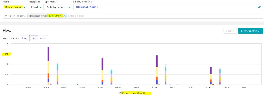

We have a peculiar problem where our application intermittently slows down. Randomly, response time increases to 5+ min and we are struggling to find a pattern or even a root cause.
Is there a way to monitor how many times this is happening per day? I created a multidimensional analysis chart for last 30 days with Response time > 1min. This still gives me a bar graph, each bar is 6 hrs. I need something that starts 00:00 and ends 23:59. The idea is that we are making many minor performance improvements, and I want to show the number of intermittent slowness instances - per day - is gradually coming down.
The starting point is the 'Transactions & Services' data. I need an end graph that shows what I want, it need not be a multidimensional analysis chart.

Clarification. My question is not about purepaths or correlation. I know how to do that, and have been doing that precisely for the last few weeks but no RCA yet.
My question is purely a data representation problem. I want DT to tell me how many times, per day, response time exceeds 1 minute. Preferably in a graph that I can simply copy paste in a report to upper management.

I thought you are looking for the reason behind this issue. 1-minute aggregation is only for the last 14 days.
In this situation, you can use multidimensional analysis like the following and plot the chart in the form of line, bar, or area.
