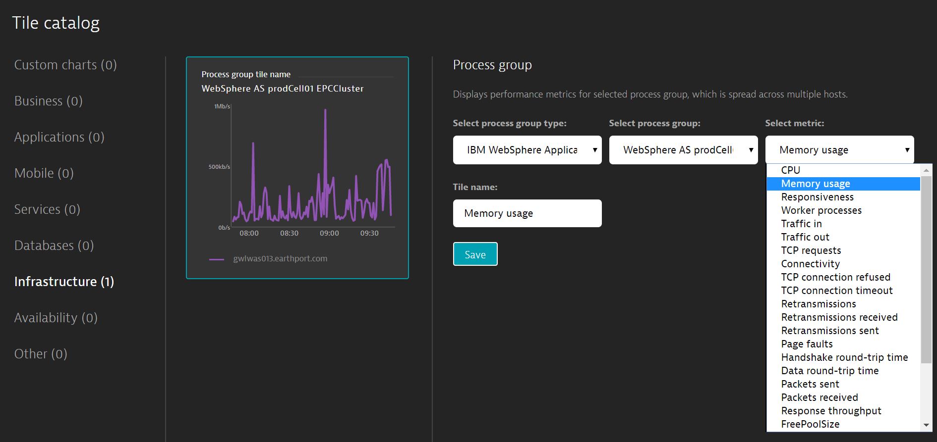

Hi, is there any way of displaying JVM metrics (committed and used memory) on a top-level dashboard for a process group?
By selecting Add tile > Infrastructure > Process group tile, I have an option for 'Memory usage', but this does not show JVM heap
details.
I would like to display the same metrics I can obtain from drilling down into each process and selecting 'JVM Metrics'. Can this be done?
Additionally, while I am here, where can I find the documentation explaining each individual metric on the drop-down list: Process Group > Select metric?

Yes you can get JVM metrics (committed and used). All you have to do is just scroll down the drop down bar and you can able to see them.
For your question, "I would like to display the same metrics I can obtain from drilling down into each process and selecting 'JVM Metrics'. Can this be done?" - Yes, this can be done. Just choose your process group and select JVM in the drop-down.

Hello there Muthu, thank you for your reply. I should have realised, this is a WebSphere feature - it appears the IBM JVM metrics are not supported. I will raise with Dynatrace Support.
Many thanks, Cam
