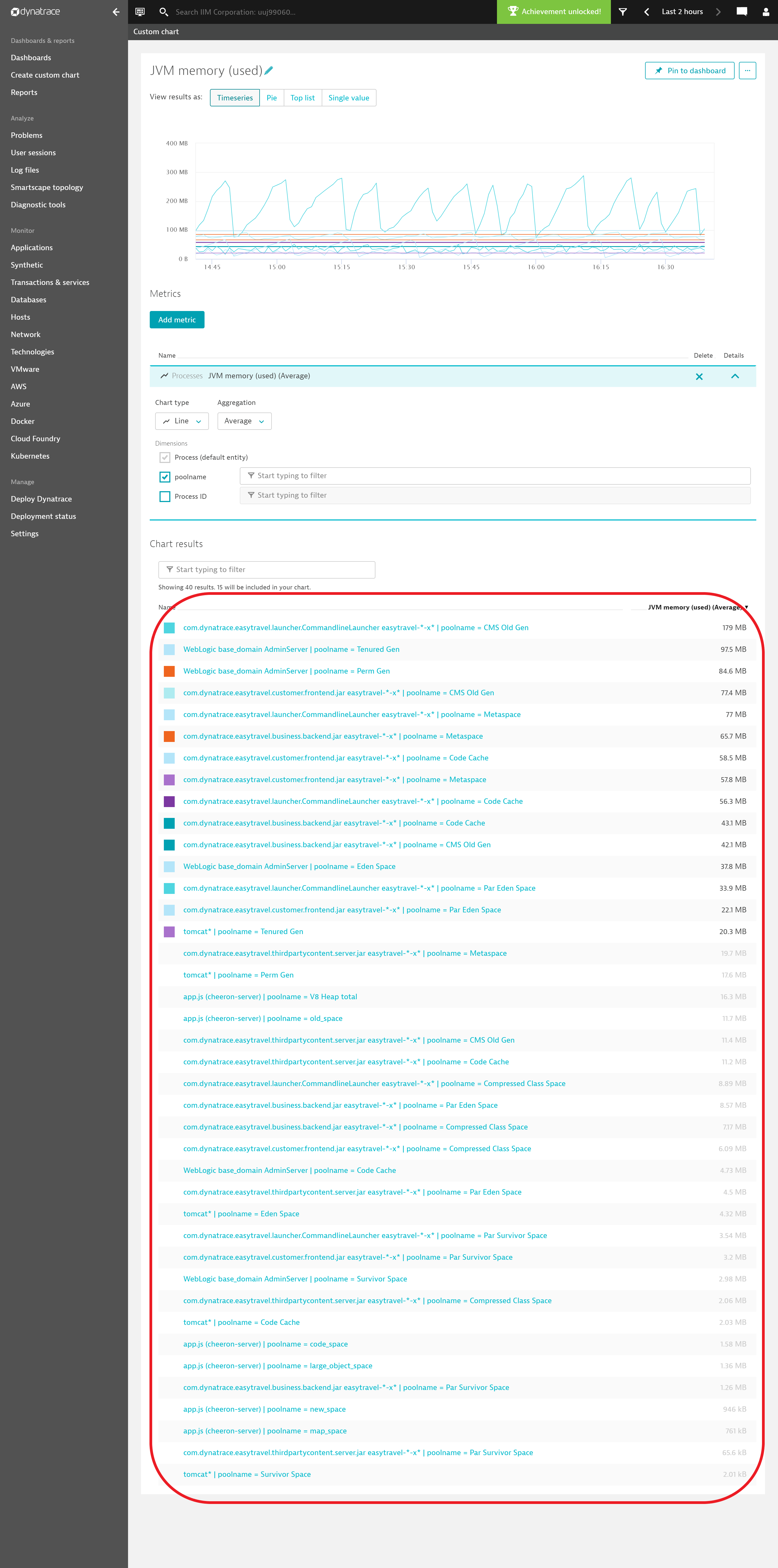

Could you tell me the max number of items that appear at the bottom of the Custom Chart?
backgrounds:
One of our customers is planning its capacity management. They want to see some DB metrics which has some dimensions like Scheme name, table name, query and so on. And they want to see all of the combinations of the dimensions. It would be so many rows of the metrics.
I know that the maximum lines of the chart are 15. But I suppose that the items and metrics on the bottom of the Custom chart become workaround. So, I think it is important to know the max number of the items.
Thanks,
Noah Kobayashi
28 Jun 2019 06:42 AM
The table itself will only show up to 100 results, but above the table we always state what the overall result set looks like. In your case it says "Showing 40 results". If you had more results, it would say something like "Showing 100 of 1140 results".
Is this the information you're looking for?
In addition to that, your customer will from version 1.172 on be able to utilize the newly introduced metrics REST API (beta) to fetch the full list of results for a given metric.
